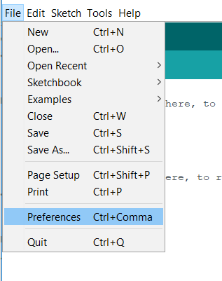

  • 2 - Click on "Files/Preferences"
  • 3 - Copy the following address in "Additional Boards Manager URLs:". If you already have other URLs present, separate them with a comma ","

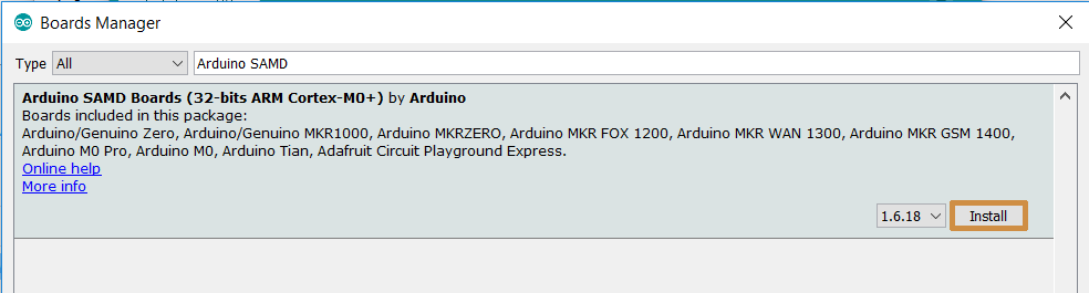

  • 6 - Click on "Tools/Boards/Board Manager..."
  • 7 - Wait for the boards list to be updated. We will now download two boards
  • 8 - Search for "Arduino SAMD" and install it

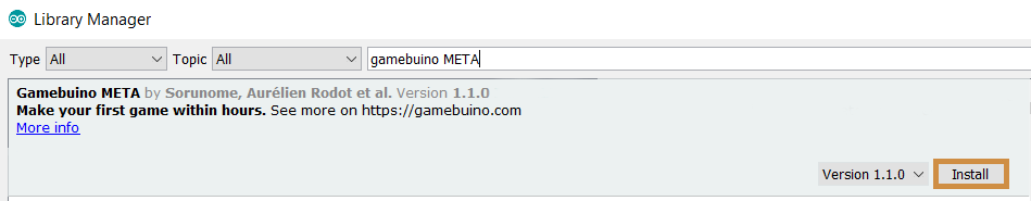

III - Install the library
  • 1 - Launch the Arduino IDE (if you closed it)
  • 2 - Click on "Sketch/Include Library/Manage Libraries"
  • 3 - Wait for the library list to be updated
  • 4 - Search for "Gamebuino META" and install it
  • 5 - Close your eyes, breathe deeply and think about the game you want to make while it's downloading.
  • 6 - Click on "Close"
